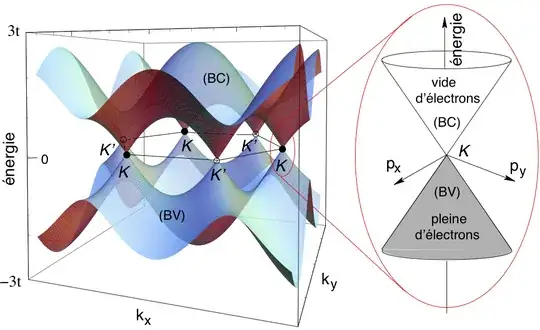

One of the main interesting properties of graphene is the appearance of Dirac points in its energy band structure, i.e. the presence of points where the valence and conduction bands meet at conical intersections at which the dispersion is (locally) the same as for massless fermions moving at the speed of light.
Image source
These Dirac points occur at the vertices of the standard hexagonal Brillouin zone, and they come in two sets of three, normally denoted $K$ and $K'$. Surprisingly, however, these two sets (despite looking much the same) turn out to be inequivalent: as far as the lattice translations know, the three $K$ points are exactly the same, but there's nothing in the lattice translation symmetry that relates them to the $K'$ points.

As you pointed out yourself, there are two sublattices and the honeycomb lattice itself is not a Bravais lattice. To construct the graphene lattice, you would use a unit cell containing two carbon atoms. Those two inequivalent atoms give rise to an additional degree of freedom (Is the electron at site A or B?). It is often refered to as pseudospin as it can be treated mathematically in the same way as the spin-1/2 property. This is the point where chirality comes in to play: In graphene, the direction of the pseudospin is linked to the direction of the electron/hole momentum. An electron's pseudospin is parallel to its momentum and for holes, it is antiparallel. Hence, the electron and hole states are called chiral states.
To sum it up, the two sublattices give rise to a spin-like property which is called pseudospin and which is linked to an electron's/a hole's momentum. This is why the property of chirality is introduced. A good read for more detail are these two articles:
