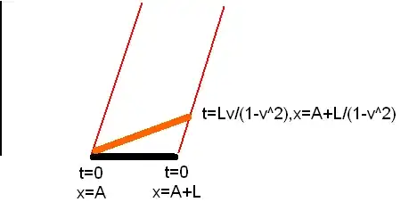

Always draw a picture!
Here the vertical black line is the observer on the ground and the two thin red lines are the ends of a moving stick.
The coordinate labels are all taken from the frame of the ground observer.
The thick black horizontal line is the stick at a given moment, according to the observer on the ground. Its length, in the ground frame, is $L$.
The thick red line is the stick at a given moment, according to a rider on the stick. The length of the stick, according to that rider, is the Lorentz distance between the two endpoints of that line. Everyone agrees on that Lorentz distance, so you can compute it in the ground coordinate system, and will easily find it to be $L_0=L/\sqrt{1-v^2}$, which is greater than $L$.
The mistake you've been making (which you'd have avoided if you'd drawn the picture!) is to think that there are two events $E$ and $F$ that represent the front and back of the stick at a given moment according to both observers. (I've changed your $A$ and $B$ to $E$ and $F$ because my picture uses $A$ for something different.) But as you can see in the picture, there are THREE relevant events here, not two. The observer on the ground is looking at the distance between the events at the two ends of the thick black line, while the observer on the stick is looking at the events at the two ends of the thick red line. That's three events altogether.

Suppose we have a rod of length $\ell$ lying along the $x$ axis in the frame $S$, and at time zero we label the spacetime points marking the ends of the rod $A$ and $B$. So for example $A$ might be the point $(0, -\ell/2)$ and $B$ would be $(0, +\ell/2)$.
In a moving frame $S'$, an observer observes the rod to have a length $\ell/\gamma$ due to the Lorentz contraction, and they label the spacetime points marking the ends of the rod $A'$ and $B'$. So for example $A'$ might be the point $(0, -\ell/(2\gamma))$ and $B$ would be $(0, +\ell/(2\gamma))$.
But ...
The points $A$ and $A'$ are not the same point and the points $B$ and $B'$ are also not the same point. When the observers calculate the length of the rod they are not calculating the distance between the same pairs of points. That is what is throwing your calculation awry.
I go into the reasons for this in detail in my answer to "Reality" of length contraction in SR and I direct you to that question for the details. In brief, for the moving observer one end of the rod is rotated into the future and the other end is rotated into the past. But of course an observer cannot simultaneously see the future and the past - they see where the ends of the rod are at the same coordinate time. That means when the observer in $S'$ sees the ends of the rod they have moved from when the observer in $S$ sees the ends of the rod. It is this movement that causes the rod to be contracted.
