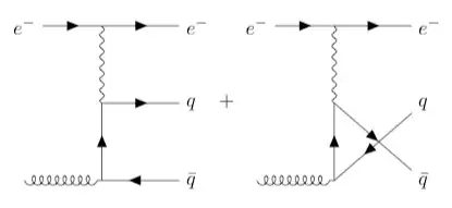

Electrons not only can interact with gluons but this interaction has been a routine measurement at electron-proton colliders. This happens through the following diagrams (at the lowest order in the strong coupling constant). Note that those are tree level (i.e. no loop). This is the leading-order contribution to the electro-production of heavy flavours, especially studied was the case where $q$ is the top quark.
