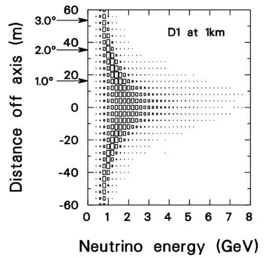

The angular distribution of products from decay-in-flight beams such as those used to generate neutrino beams and radioactive beam accelerators (PDF link) are a sensistive test of this prediction.
I don't know of a paper discussing the focusing specifically (because I am an end user rather than creator of such beams and it's now a 50 year old technology), but an example of measuring the angular distribution is
Fig. 1. Density plot showing the variation in neutrino spectrum shape over a $3^\circ$ angular range $1.5\,\mathrm{km}$ from the production target.
which is figure one from http://physics.princeton.edu/~mcdonald/nufact/e889/chapter3a.pdf on the NuMI beam at Fermilab.
Notice how the higher energy component of the beam is narrower than the low energy component, an expected feature of kinematic focusing.
