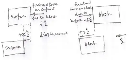

Corrected answer as a result of the comments made by @ValterMoretti
I have found it easier to understand what is happening by applying the constant kinetic frictional forces on the “sides” of the surface and the block rather than on top or underneath.
I think that this way of presentation helps to understand the displacements which are involved.
When discussing or answering such question the first thing to do is to define the system under consideration.
Consider a block as the system and it is sliding along a rough horizontal surface with an external kinetic frictional force $-f \hat i$ acting on the block due to the surface.
If the displacement of the block is $+y\hat i$ then the work done on the block by the frictional force is $-fy$ and if you were using the work-energy theorem this would produce a change (reduction) in the kinetic energy of the block.
Consider a surface (and the Earth) as the system.
There is an external kinetic frictional force $+f \hat i$ acting on the surface due to the block.
However the displacement of that frictional force is now $x \hat i$ and so the work done on the surface by that frictional force is $+fx$.
This produces an increase in the kinetic energy of the surface but because the displacement of the surface is less than that of the block, the gain in kinetic energy of the surface is less than the decrease in kinetic energy of the block.
The difference is the heat produced which enters both bodies.

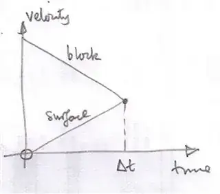

The difference in the displacements can be shown as follows.
Assume that the mass of the surface (and the Earth) is greater than the mass of the block.
The magnitude of the impulse $f \Delta t$ on the surface and the block must be the same so the magnitude of the change in momentum of the surface and the block must be the same.
Since the mass of the surface is more massive than the block the magnitude of the acceleration of the surface must be less than that of the block.
As the interaction times $\Delta t$ are the same for both the surface and the block the velocity vs time graphs for the two objects show the displacement of the surface (area under graph) to be less than that of the block.
In practice because the Earth is so massive the displacement $x$ is taken to be zero.
A good example of the point of contact not moving and work done by a static frictional force is you sitting on a seat with no back rest in a car which is accelerating.
Now in this case the displacement $x$ of the two static frictional forces on you and on the car seat is the same.
You and the car seat accelerate but whilst doing so you do not move relative to the car seat because there is a static frictional force between you and the car seat.
If you are the system then you have an external static frictional force acting on you $+f\hat i$ due to the car seat and after a displacement of $x \hat i$ that static frictional force does $fx$ amount of work on you.
Your kinetic energy increases.
At the same time there is $-fx$ amount of work done on the car seat by the static frictional force that you exert on the car seat.
