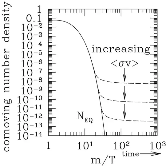

This is depicted in the figure below. At early times T is high and the number densities are given by the formulas above, this is depicted by the solid black line. As T drops we observe that the effective particle densities are higher than those expected from the equilibrium calculations (i.e. B or C type particles in our above example).
Note that the final density depends on the crossection of the decay, this is sensible since a higher crossection means that the reaction will remain in equilibrium for longer such that it will follow the full curve for longer.
