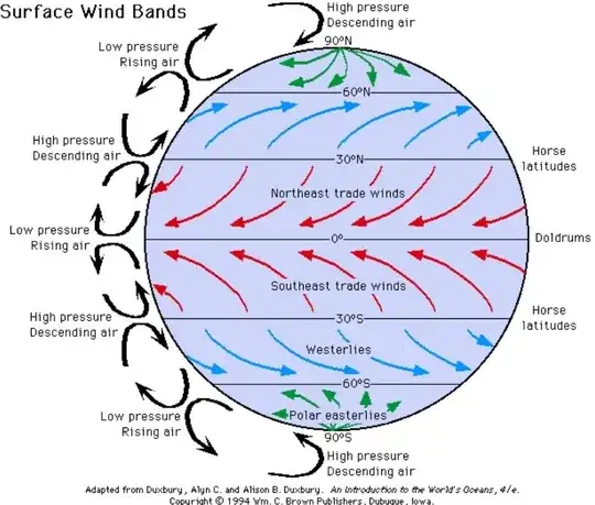

Another example is the circulation of large air currents in the atmosphere the direction of which are determined by the rotation of the Earth.
These are due to the Coriolis force.
