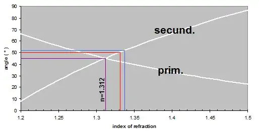

The radius of the rainbow is: $$\phi_0(n,k)=\pi-2 \arcsin q +2(k+1)\arcsin \frac{q}{n} - k \pi$$  where n is the index of refraction, k is the order of the rainbow (k=1 primary rainbow, k=2 secondary), and the auxiliary variable q is $\sqrt \frac {(k+1)^2-n^2}{(k+1)^2-1}$.
The graphs of $\phi_0(n,1)$ and $\phi_0(n,2)$ intersect at n=1.312. This index of refraction corresponds to a wavelength of about 1600 nm. (Fig 8) Probably an infrared camera for this wavelength exist, but it might produce an unspectacular black and white image.
