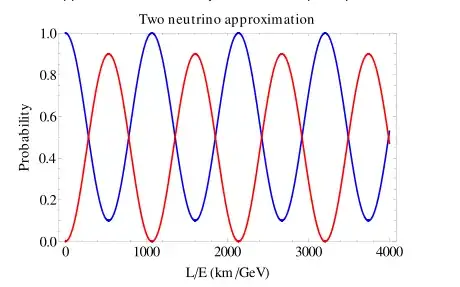

In the approximation where only two neutrinos participate in the oscillation, the probability of oscillation follows a simple pattern:
oscitwoneutr
The blue curve shows the probability of the original neutrino retaining its identity. The red curve shows the probability of conversion to the other neutrino. The maximum probability of conversion is equal to sin^2(2θ). The frequency of the oscillation is controlled by Δm^2.

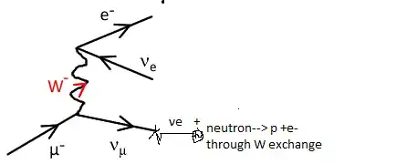

Suppose the beam has muon neutrinos, so starting with a definite flavor and mass
feynneutriosc
I am not good at drawing . The image wants to convey that the muon neutrino line that has a probability of turning into an electron neutrino line is off mass shell, i.e. virtual. Energy and momentum are balanced at the vertices where the real on shell particles come out, in this case a proton and an electron.
