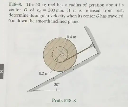

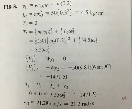

In the solution they are just using the conservation of energy principle, i.e.: $PE_1$ + $KE_1$ = $PE_2 $+$ KE_2$ leaving out any work (smooth surface).
I don't understand how tension doesn't do any work. The rope is attached to the spool and the spool is rotating and sliding.
Is it only because the displacement of tension is 0 because as it unravels, the points of contact change? That's the only logical explanation I can come up with...
EDIT:
"They" are the authors of the textbook. And here's the solution where they use $T_1 + V_1 = T_2 + V_2$, where $T=KE$ and $V=PE$.

Full problem statement.

I seem to have misunderstood the question. The frictionless case here is not between the spool and string, but rather the spool and slope. There is static friction between the string and spool as pointed out by Armando. If we take this to mean that the string doesn't "slip" on the spool, then it doesn't change much and the equation the solution uses is correct (as far as I can tell).
If you can't see how the tension doesn't do any work, picture this. Imagine a motorcycle chain around a gear that is on a frictionless axle. You attach the motorcycle chain to a mass that falls a certain height. $X$ Newtons would be the weight of the mass and how then do you calculate the rotational kinetic energy of the gear ? You could equate the loss in gravitational potential energy to the gained rotational kinetic energy of the gear. Since the chain doesn't slip/rub against the gear, we have eliminated sources of sliding friction while maintaining an analog of the static friction. No work is lost in the tension because there is no sliding and no heat generation (static friction produces no heat). The chain doesn't move relative to the gear just like the rope doesn't move relative to the spool.
In the solution they are just using the conservation of energy principle, i.e.: $PE_1 + KE_1 = PE_2+ KE_2$ leaving out any work (smooth surface).
If I understand this sentence correctly, then I think my answer is accurate. No tension will be present if there is no friction. The friction is what "pulls" on the string. No friction = nothing pulling the string because the string would slide frictionless round and round the spool.
