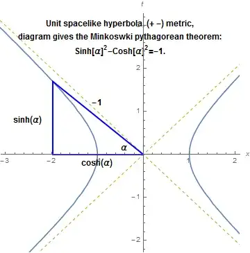

  4. You say "imaginary triangle", I say "Minkowski geometry". Potato potato. I think you're incorrect that "If you insist that distances are real and use a Pseudo-Euclidean metric, [that] would imply entirely different values for these angles." For example, the following diagram is one in Minkowski space for which $\alpha$ is a hyperbolic angle. The unit spacelike hyperbola takes the place of the unit circle. The "-1" is because the hyperbola is spacelike. The "$\alpha$" is the hyperbolic "angle".
