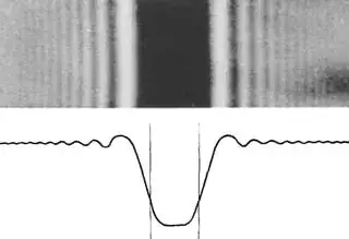

Deflection
Experiments with point-like sources and the observation of fringes (intensity distributions) behind obstacles are done with electrons too (Bi-prism experiment by Möllenstedt and Jönnson, see Zeitschrift für Naturforschung 10 a S. 256 a). In contrast to the definition of diffraction as bending radiation into the region of geometrical shadow the results of this experiments have shown that the electrons get deflected only away from the geometrical shadow:

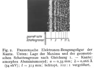

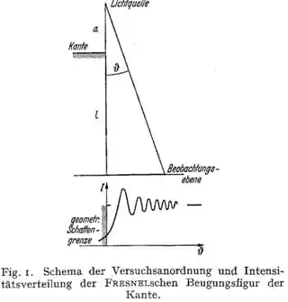

Some years before this biprizm experiment Hans Boersch published Fresnel'sche Elektronenbeugung (an article from 1940 behind a paywall :-0). It was shown that electrons behind an edge get deflected (Beugung = deflection):

  1. Not only behind a separate slit diffraction occurs but deflection occurs behind every (sharp or thin) edge.
  2. The intensity distribution (fringes) starts for EM radiation inside the geometrical shadow and for electrons at potential-free edges outside the geometrical shadow. So for photons and for electrons the diffraction happens in different ways.
  3. Yes you are right with the implication in your question in the sense that somehow the intensity distribution of the four edges of a double slit is the sum of the distribution behind every of the edges. You could call it interference or simply intensity distribution.
