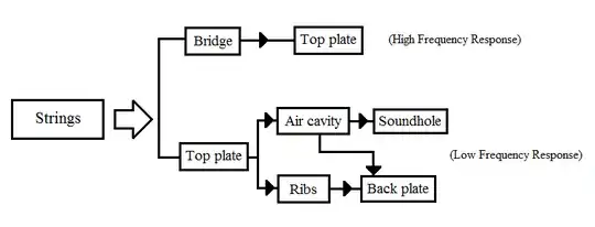

The sound from a guitar can be depicted with the following figure (ref 1).
From this figure, guitar behavior can be described as follows: At low frequency, guitar transmits vibrations through the bridge to the top plate, which displaces fluid inside the cavity and induces pressure changes that cause soundhole radiation. Vibrational energy is also transmitted to the back plate via both the ribs and air cavity pressure changes. At high frequency, most of the sound is radiated by the top plate and the role of the bridge becomes more relevant (ref 2).
Then, we have three major parts involved
  1. Strings;
  2. Body; and
  3. Enclosed air.
Strings are important because they are the source of the sound. Steel strings give a different sound than nylon strings, for example. It is also important how the strings are perturbed/played: bowed, fingered, plucked. This is because they would have different spectral composition.
The other parts, can be viewed somehow as filters that you apply to your signal, and you would end up with a different spectrum, that is, a different timbre and therefore, a different tone quality.
