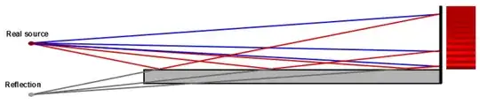

The Lloyd's mirror arrangement to show interference has a dark fringe when two physical path lengths are the same.
There is a source of light above a flat glass plate.
Light reaches position to the right of the glass plate either having travelled there directly (blue rays) or after being reflected the the glass plate (red rays).
Those reflected rays appear to come from the virtual image of the light source.
The two sources (one real and one virtual) are coherent but because of the $\pi$ phase change of the light after reflection from the glass plate are $\pi$ out of phase.
This means that when the physical path difference is zero a dark fringe is formed.
