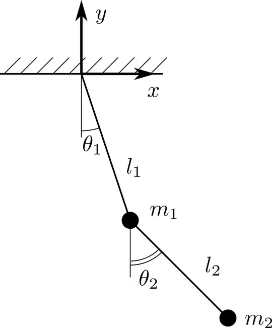

To see how the formalism works I studied double pendulum as a practical example.
Let $Q_1$ and $Q_2$ be first defined in Cartesian system $(x_1, y_1)$, $(x_2, y_2)$. Euclidean metric in both of them $g_E$ is given as
$$g_E = dx \otimes dx + dy \otimes dy $$
Let's do the variable substitution:
$$ \begin{cases} x_1 = l_1 \sin \theta_1, \\ y_1 = - l_1 \cos \theta_1, \\ \end{cases} $$
$$ \begin{cases} x_2 = l_1 \sin \theta_1 + l_2 \sin \theta_2, \\ y_2 = - l_1 \cos \theta_1 - l_2 \cos \theta_2, \\ \end{cases} $$
In new coordinates $g_1$ for $Q_1$ and $g_2$ for $Q_2$ are:
$$g_1 = m_1 l_1^2 \, d \theta_1 \otimes d \theta_1$$
$$ \begin{multline} g_2 = m_2 \left[ l_1^2 \, d \theta_1 \otimes d \theta_1 + l_2^2 \, d \theta_2 \otimes d \theta_2 + \right .\\ \left. l_1 l_2 \left(\cos(\theta_1 - \theta_2)\right)(d \theta_1 \otimes d \theta_2 + d \theta_2 \otimes d \theta_1) \right] \end{multline} $$
To obtain the form of kinetic energy in the Lagrangian setting:
$$ \begin{multline} T(\dot \theta_1, \dot \theta_2) = \frac{1}{2} g\left( \dot \theta_1 \frac{\partial}{\partial \theta_1} + \dot \theta_2 \frac{\partial}{\partial \theta_2}, \dot \theta_1 \frac{\partial}{\partial \theta_1} + \dot \theta_2 \frac{\partial}{\partial \theta_2} \right) = \frac{1}{2} (g_1 +g_2) = \\ \frac{1}{2} m_1 l_1^2 \dot \theta_1 \dot \theta_1 + \frac{1}{2} m_2 \left[ l_1^2 \dot \theta_1^2 + l_2^2 \dot \theta_1^2 + 2 l_1 l_2 \left(\cos(\theta_1 - \theta_2)\right) \dot \theta_1 \dot \theta_2 \right] \end{multline} $$
Up to this point all the calculations were conducted by pure algebraical tossing of symbols that I did by hand. No drawings or whatsoever, actually that was the goal --- given the metrics do everything further as a machine, blindly. Unfortunately I don't know yet the easy way to cast kinetic energy in Hamiltonian form. One can do a Legendre transform or, as I did resort to CAS to find the inverse matrix:
$$ \begin{multline} T(p_{\theta_1}, p_{\theta_2}) = \\ \frac{1}{2} \begin{bmatrix} p_{\theta_1} & p_{\theta_2} \end{bmatrix} \begin{bmatrix} (m_1 + m_2) l_1^2 && m_2 l_1 l_2 \left(\cos(\theta_1 - \theta_2)\right) \\ m_2 l_1 l_2 \left(\cos(\theta_1 - \theta_2)\right) && m_2 l_2^2 \end{bmatrix}^{-1} \begin{bmatrix} p_{\theta_1} \\ p_{\theta_2} \end{bmatrix} = \\ = \frac{ \left(m_2 + m_1 \right) l_1^2 p_{\theta_2}^2 + l_2 ^ 2 m_2 p_{\theta_1}^2 - 2 m_2 l_1 l_2 p_{\theta_1} p_{\theta_2} \cos \left(\theta_2 - \theta_1\right) }{ 2\left( l_1^2 l_2^2 m_2^2 + l_1^2 l_2^2 m_1 m_2 - l_1^2 l_2^2 m_2^2 \cos \left(\theta_2 - \theta_1 \right)^2 \right) } \end{multline} $$
