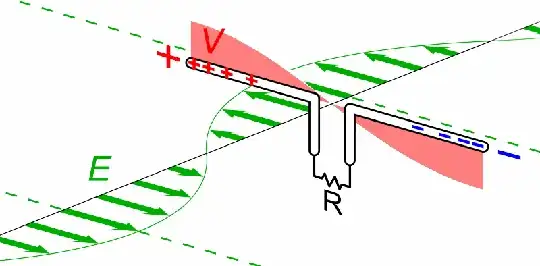

Here is a nice animation which illustrates what happens if an incoming plane polarised oscillating electric field is incident on a dipole antenna.
The electrons in the dipole antenna are forced to oscillate and hence a alternating voltage is developed across the resistor.
If the length of the dipole is chosen correctly, the length being related to the wavelength of the electric field, there is a resonance effect and so the alternating current through the resistor can be large enough to detect.
The animated diagram tries to show this by having what looks like a standing wave produced in the antenna. You can now imagine that putting a diode in place of, or in series with, the resistor as suggested by Feynman will produce a unidirectional current/voltage which could be amplified.
In practice one can improve the arrangement by first making sure that as much power as possible is transferred from the antenna to the detecting circuit by careful design of the detecting circuit which will then contain the diode.
Now rotate the electric field through $90^\circ$ and there will be an oscillating voltage across a diameter of the wire but its magnitude will be considerably smaller than with the electric field being the the same plane as the antenna.
As Feynman pointed out this will give a zero reading at the detector end.
You have suggested rotating the detector circuit around so that the voltage across a diameter of the wire could be measured.
Even if you had such a detecting circuit, because the diameter of the antenna would be so different from the the wavelength of the electric field, the amplitude of forced oscillation of the elections would be very small leading to a minute voltage to be detected.
