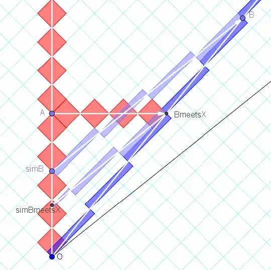

Spacetime diagrams might help clarify some ideas.
In the context of your scenario, if two observers in relative motion agree on the elapsed time between two events, then you are back to the absolute time structure of Galilean physics. That structure is not compatible with the principle of relativity and the speed of light principle. For example, if the two observers exchange light-signals "at the same time", they would receive the signals at different times.
So, let's look at the details using a spacetime diagram on rotated graph paper, in accordance with special relativity.
Let's let each light-clock diamond represent 5 years. I've marked the event when the spaceship (B) meets Planet X. (Implicitly, B continues past Planet X.)
As you've said,...
In the earth frame (along OA), that event occurs 25 years after the separation event O, at a location 20 light-years away from OA. Note these measurements use the earth's light-clock diamonds and uses the event A, which the earth says is simultaneous with event BmeetsX.
In the spaceship frame (along OB), this event BmeetsX occurs 15 years after the separation event O.
However, in the spaceship frame, BmeetsX still occurs 15 years after event O. Note that, in the spaceship frame, event A is not simultaneous with BmeetsX... it's simBmeetsX that is simultaneous. (That occurs at (15 y)/gamma=(15 y)/(5/3)=9 years [1.8 diamonds] according to the earth frame.) In addition, that event is (2.4 diamonds)*(5 yr/diamond)=12 light years away. (Indeed, from the spaceship frame, the earth traveled 12 light years in 15 years... and does so with speed (12 ly)/(15 y)=0.8c.)
All of the proportions in the previous paragraph are correct. But if you want to see a direct comparison, the spaceship should wait until 25 years (5 diamonds) have elapsed on its worldline... the event I labeled B. In that case, the event on the earth that the spaceship says is simultaneous with B is simB. I think you can see that simB is 15 years after event O, and that simB is 20 light years away. So, there is the symmetry displayed.

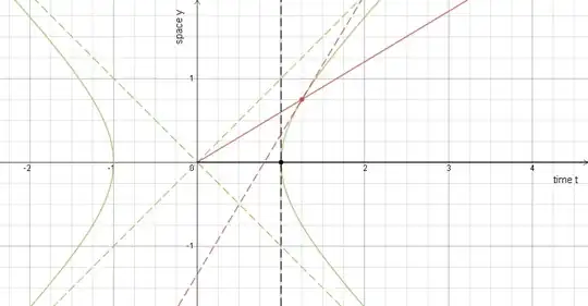

Underlying these diamonds is the geometric structure of special relativity: Minkowski spacetime geometry, whose "circles" [figures of equal time-elapsed] are hyperbolas. In the diagram below, time runs to the right [rather than upward, as in the earlier diagrams].
https://www.desmos.com/calculator/ti58l2sair hyperbolas in Minkowski space
When an observer's worldline meets that unit hyperbola [marking one tick of that observer's clock], the tangent at the intersection defines the events simultaneous with the intersection event according to that observer. (Those lines are parallel with the spacelike diagonals of the light-clock diamonds.)
Now here is the answer to Question 2.
Note how an observer's line-of-simultaneity cuts the other observer's worldline before that observer reaches the hyperbola... and that fraction is the same for each observer. In fact, that fraction is 1/(time-dilation factor).
In the simulation, if you tune "E" to 0, you get back to the Galilean case.
If you tune "E" to -1, you can see the Euclidean analogue.
