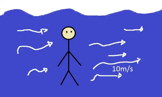

The person is completely naked and submerged into the water. His temperature is 37ºC. He does not move in the water. The water flowing past the person is moving at a V speed, for example 10m/s.

For 10m/s water flow, the Reynolds number is $1 \times 10^{12}$, so it is turbulence flow. For 10m/s air flow, the reynolds number sis about $6 \times 10^{8}$. So both a turbulence flow.
The heat transfer coefficient can be obtained for the convective heat transfer. The air heat transfer coefficient is about $32W/m^2K$ , refer to http://www.engineeringtoolbox.com/convective-heat-transfer-d_430.html and the water heat transfer coefficient is between $300-6000W/m^2K$. By the way, even a strong person may not stand in a 10m/s flow current.
This gives -1095~-6795 degC. So you see it is impossible to achieve the same effect with air. It really because water can take away significant heat.
