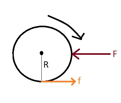

The cylinder will continue to roll forever unless it is acted upon by an external unbalanced force. There are situations where you can accelerate the object while pure rolling. One situation where this happens is shown in the figure below:
Let $f$ be the frictional force.
Let $F$ be the external force ($\le f_{max} = \mu N$).
The condition for an object pure rolling is:
$$v_{com} = \omega R \tag{1}$$
The translational velocity of the lowermost point cancels out the rotational motion of the lowermost point completely.
Differentiating the equation $(1)$ with respect to time, you get:
$$a_{com} = \alpha R \tag{2}$$
The translation acceleration can be compensated by angular acceleration such that as the translation velocity increases (or decreases), the angular velocity also increases (or decreases) to ensure that condition $(1)$ is satisfied.
In this case, there is no kinetic friction as the contact surfaces are still at rest. However, static friction acts (had it not, there would be relative motion as $v$ would change without affecting the value of $\omega$ which would cause the $(1)$ to fail).
The net force ($F_{net}$) and torque ($\tau_{net}$) can be calculated as follows:
$$F_{net} = ma = F - f \tag{3}$$
$$\tau_{net} = I\alpha = -fR \tag{4}$$
You have three equations (equation $(2)$, $(3)$ and $(4)$) and three unknowns ($f$, $a$ and $\alpha$). You can solve for $a$ and $\alpha$. From these values, you can calculate the time it takes for the body to stop rolling.
