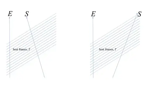

  2. (Actually this is of course one way to deriver the Doppler shift): draw a Minkowski diagram (see my sketch below), with regular framing pulses $T$ being sent from the Earth's worldline ($E$). Then work out the Minkowski length of the successive crossings of the spacefarer's world line $S$ by these framing pulses. You can see at a snap that the rate depends on the direction.
Doppler Shift
