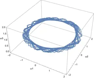

I actually checked. Of course $50000$ seconds depends on your timescale and on your values for $\vec \omega$. I chose $(\omega_1(0),\omega_2(0),\omega_3(0))=(2,0,1)$ and used $I_2=2, I_3=1$ and variable $I_1$. I got the kinetic energy $$ 2T_{rot}= \sum_k I_k\omega_k^2 $$ to be conserved all the way to $t=50k$ using a variety of methods. However, I do not quite trust some qualitative features of the numerical solutions.
For instance, with $I_1=I_2=2$, one should obtain a simple precession about the third axis. While my schemes show that $L_3=I_3\omega_3(t)$ is indeed constant, the other two values of angular momentum to not remain exactly on a circle but rather seem to oscillate, as you can see from the figure, with $\vec\omega(t)$ plotted to $t=250$.

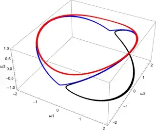

On the other hand, there is a critical value $$ I_{1c}=\frac{I_2}{2}+\sqrt{\frac{I_2^2}{4}+I_3(I_2-I_3)\left(\frac{\omega_3(0)}{\omega_{1}(0)}\right)^2}\, . $$ which separates two types of motion. For my values this works out to be $I_{1c}=2.11803$. Taking the values $I_1=2.08$ and $2.12$ on either side of this critical value gives "good" curves of $\vec\omega(t)$ up to $t=2500$, as you can see below. The blue curve is very nearly the separatrix and was obtained using $I_1=2.118$; the red and black curves correspond to $I_1=2.08$ and $2.12$ respectively.
All of these were obtained using Mathematica and forcing the Method to RK of difference order $4$. Thus I suspect it's likely to be your integrator that is buggy.
