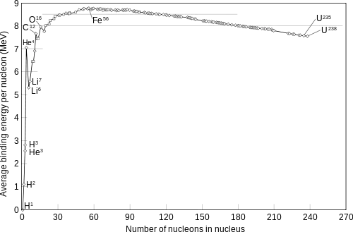

If so, the daughter element would move to the right of the peak and its parents (away from the point of Iron-56), on the following graph (meaning additional energy is required, as opposed to energy being emitted), right?

Exoenergetic fusion past iron is impossible. Endoenergetic fusion is per se not impossible and it is a valid nuclear reaction. In fact it is the way very heavy elements are produced in particle accelerators for example:
$${}^{208}_{~~82}\mathrm{Pb}+{}^{62}_{28}\mathrm{Ni}\rightarrow {}^{269}_{110}\mathrm{Ds}+{}^{1}_{0}\mathrm{n}$$
Lead-208 fuses with nickel-62 to darmstadtium-269 and a neutron. This fusion reaction is of course endoenergetic and requires a heavy-ion accelerator to bombard the lead with high energy nickel nuclei.
