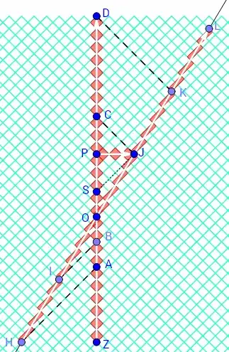

The following spacetime diagram may help
spacetime diagram
Two inertial observers, Alice (along AD) and Bob (along HL), will meet momentarily at event O. In this diagram, Alice is at rest and Bob's velocity is PJ/OP=3/5 according to Alice. ( 3/5 is chosen to make the arithmetic easier and to make things easier to draw on rotated graph paper. )
The Lorentz factor (according to Alice) is the ratio OP/OJ=5/4, where Alice regards P and J as simultaneous. (By a radar experiment to measure J, Alice must send a signal at S and receive at C. Then the midpoint-event P is simultaneous with J.) You can check that for $v=3/5$, then $\gamma=1/\sqrt{1-v^2}=5/4$.
[Trigonometrically, the Lorentz factor $\gamma$ is the hyperbolic cosine of the rapidity angle $\theta$ between the worldlines: (ADJACENT/HYPOTENUSE)=OP/OJ=5/4. The velocity is the hyperbolic tangent: (OPPOSITE/ADJACENT)=PJ/OP=3/5.]
What Alice "sees" (with her eyes by looking out the window) are the images of Bob's clock, as marked by the dashed lightlike lines sent from Bob's periodically ticking clock [at events H, I, O, J, K]. When Bob is approaching, Bob's clock visually appears to be running fast according to Alice: HI/AB=4/2=2. Think of Alice watching the incoming images of Bob's clock while watching her own clock. Here's a TV transmission interpretation. If each diamond on a worldline represents 15-minutes, a 60-minute broadcast by Bob is viewed by Alice [once received] in 30 minutes. After the momentary meeting and Bob recedes, Bob's clock visually appears to be running slowly according to Alice: JK/CD=4/8=(1/2). Bob's 60-minute broadcast now takes Alice 120 minutes to view. These ratios HI/AB and JK/CD are associated with the Doppler factor $k=\sqrt{\frac{1+v}{1-v}}=2$.
[Trigonometrically, $k=\exp\theta=(\cosh\theta+\sinh\theta)=\cosh\theta(1+\tanh\theta)=\gamma(1+v)$].
(The same diagram can show that Bob would observe the same thing about Alice by drawing a different set of lightlike signals sent from a periodic sequence of Alice's ticks.)
