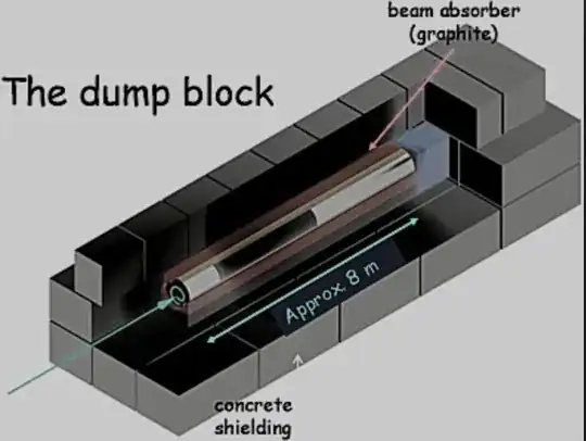

In the case of the LHC, yes the beam can do quite a lot of damage.
At full power there is something like 350MJ stored in the beam - close to a freight train, or roughly the kinetic energy of a full jumbo jet at take-off. There is a very complex safety system to dump the beam safely eventually steering the beam energy into a large block of graphite inside a much larger cooled block of metal inside a very big block of concrete.
Without this any instability in the beam could allow it to hit the wall of the vacuum tube where it would slice through it and then through the magnets like a hot knife through butter, or indeed like a high intensity beam of relativistic protons through superconducting magnets which is more impressive and a lot more expensive.

This is where the beam ends up after an accelerator run. It's possibly counterintuitive, but a light, high melting point block of graphite is used to absorb the energy of the beam. If lead or another metal was used, it would melt, and a messy cleanup and replacement block would be required after each run. This block of graphite is intended to last the lifetime of the LHC.
