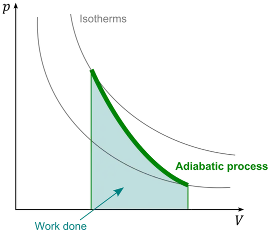

How a heat engine works, in a single work cycle, can be roughly modelled by adiabatic expansion. I copied over the image:
adiabatic curves
The working fluid, typically gas, does (positive) work by moving bottom-right, increasing $V$ and decreasing $p$, also $T$. For a simple and rough estimate, let's assume the fluid is ideal gas; it usually is not very far from that in typical civilian engines. Then the isotherms have the form $$p \propto TV^{-1}$$ and the adiabatic curve $$p \propto V^{-\gamma}$$ where $\gamma = \frac{C_P}{C_V}$.

Then let's think about its "slope": is it better to be steep, or flat?
I would say the flatter the better.
Being "steep" means it undergoes a greater change in $p$ and, somehow less (compared to a flatter one) of that in $V$; think about it. At the very best we can have $p$ stop at 1atm, so for a good output from a steep curve, we would need to start at a $p$ much higher than 1atm. That means we would need to design our engine so that many parts need to sustain a lot of pressure; we may need a super beefy pressure chamber for heating the working fluid. We would also need heavy moving parts so as to sustain, in case of failure e.g. the output shaft is stuck stationary, possibly the full pressure as it comes out of heating chamber. Such added weight would very likely contribute to the total efficiency negatively, as well as making the machine harder to build, and more dangerous.
So, assume you agree to that, we should prefer a flat curve, so that the pressure does not change dramatically, but doing the work gradually over a greater expansion. Observing that, in most cases, the isotherm curve shall decend (how could it be hotter after doing work?), meaning $\gamma > 1$, the best we can hope for is a $\gamma$ that is close to 1. That is achieved with a high specific heat.
