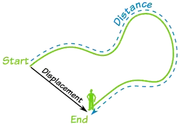

Note that this velocity is a vector describing how fast (=speed) and in what direction you are moving at any moment in time (therefore the time dependence). $\Delta (\mathrm{displacement})$ is the displacement and is also a vector, going from a point along the path reached at time $t$ to a point reached at a later time, $t+\Delta t$ as in the image above.
As you can see from the image, if you look at the displacement after a very short time (i.e. you take the limit $\Delta t\to 0$), the displacement vector (and the instantaneous velocity) will in fact be along the track.

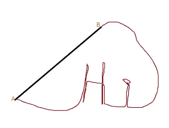

You must think displacement as the shortest distance between two points. Distance is the actual distance you travel while going between two points.
In the above example, the length of the black line gives the displacement between the two points $A$ and $B$ and the length of the brown line between the two points $A$ and $B$ gives the distance traveled.
