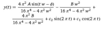

a undamped mass-spring system with harmonic force input: enter image description here
which can be solved by Wolfram: enter image description here
In conclusion, if you apply a harmonic force on a linear mass-spring system, the resonance occurs regardless of damping and the initial conditions (e.g. different phase of a swing vibration).
