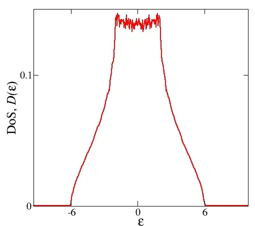

I calculated numerically the density of states (DoS) for the 3-D tightbinding dispersion $\epsilon(k_x,k_y,k_z)=-2t\,(\cos k_x + \cos k_y + \cos k_z)$ and obtained the following plot [$t=1$ has been chosen].
What I did is summing over $k$-points of the lattice Green's function, $$G(k_x,k_y,k_z,\omega)=\frac{1}{\omega-\epsilon(k_x,k_y,k_z)+i0^+}$$ and finding the DoS from its imaginary part : $D(\omega)=-\frac{1}{\pi}\text{Im} \sum_{k_x}\sum_{k_y}\sum_{k_y} G(k_x,k_y,k_z,\omega)$.

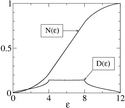

One can easily notice that there are noises at low energies. Is there any alternative way to get better result? Like the one shown in a figure from a paper [Ref: arXiv:1207.4014] :
Can there be some mathematical standard expression that can be calculated through Mathematica or Matlab?

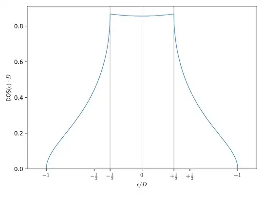

With Matlab or Mathematika I cannot help, but in Python there is an implementation available: sc_dos enter image description here Here $D$ is the half-bandwidth $D = 6t$.
import numpy as np
import gftool as gt
eps = np.linspace(-1.2, 1.2, num=6001) dos = gt.sc_dos(eps, half_bandwidth=1)
The evaluation of the DOS takes for me ~100 ms.

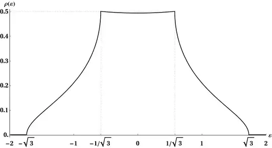

You can reduce the noise using an elliptic integral.
$$D(\varepsilon)=\frac{1}{4 \pi ^3 t}\int_{-\pi }^{\pi }d\phi K\left( \sqrt{1-\left(\frac{\varepsilon +2 t \cos\phi }{4 t}\right)^2}\right)$$
Where K is the Complete Elliptic Integral of the First Kind: http://mathworld.wolfram.com/CompleteEllipticIntegraloftheFirstKind.html.
It's not trivial to get here. And even from this expression the integral needs to be done numerically with care (it has singularities for many values of $\varepsilon$) but it should give better results. Running for six seconds in Mathematica gives me (with $t=\frac{1}{2\sqrt{3}}$): enter image description here

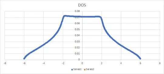

I had the same trouble. I used the formula $\rho(\epsilon)=\sum_{\vec{k}}\delta(\epsilon - \epsilon(\vec{k}))$ to numerically calculate the density of states. I did a summation over $100$ $k-$values for each component, and used a Gaussian distribution with $\sigma =0.1$ for the delta function to get the following diagram. Using larger $\sigma$ ends up smoothening out the singularity in the derivative at around $\epsilon=\pm 2$.
The code was written in C++, and ran for about $60$ seconds. $y$ axis is $\rho(\epsilon)$, $x$ axis is $\epsilon$ and $t=1$.
PS: I did the summation over half the Brillouin zone, which was what I needed for my application.
