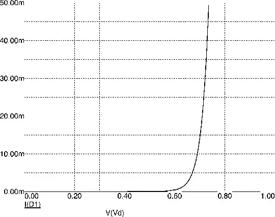

If you measure the current as a function of voltage for a forward bias you get something like:
V-I curve
(image is from this question)
The knee voltage ($0.65 - 0.7$V in this case) is a measurement of the potential across the junction.
