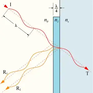

This shows the idea of an antireflection coating. Attribution below. The coating is 1/4 wavelength thick. Light that bounces off the back surface travels an extra 1/2 wavelength. It emerges out of phase with the front reflection. The two reflections cancel.
It doesn't really work on something as thick as a pane of glass. You can't make the front and back surfaces of glass exactly parallel and exactly the right separation.

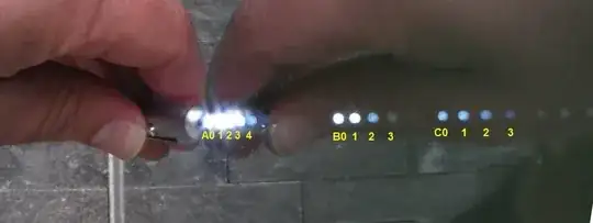

It is best seen by using a point source, as in the photo. Image A0 is due to a single reflection in the first pane, B0 is due to a single reflection in the second pane, C0 is due to two reflections in the second pane. The other images are due to multiple reflections inside a pane. So the A-images are light from the first pane, and the B- and C-images would disappear if the second pane was removed.
double pane window

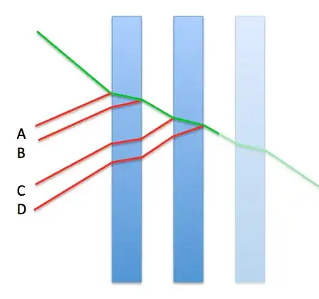

Here is a diagram that demonstrates this:
Reflections A and B will happen with just a single pane; C and D are added with a second pane, and you can keep going.
