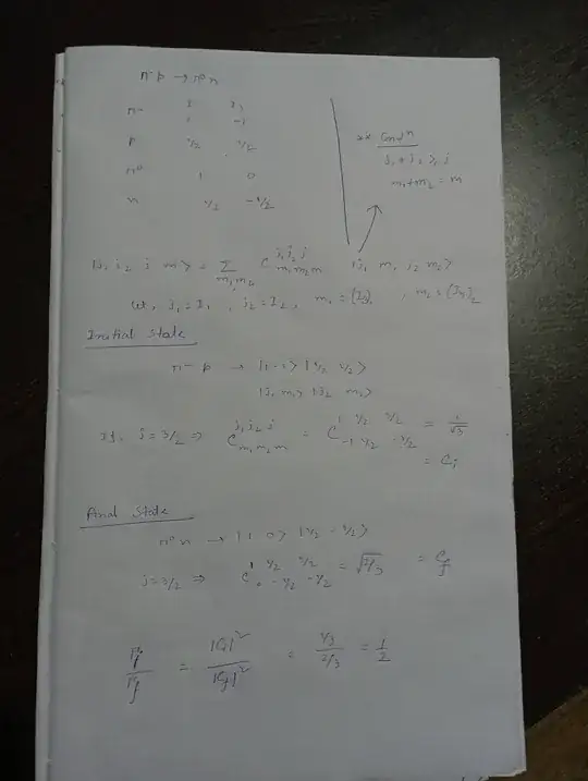

Reaction $$\pi^- p \rightarrow \pi^0 n$$ has a peak due to $\Delta$ resonance, which has a mass 1232 MeV and $\Gamma$ = 120 MeV. The partial widths are $\Gamma_i = 40$ MeV and $\Gamma_f = 80$ MeV. I need to explain why the ratio of $\frac{\Gamma_i}{\Gamma_f}$ is equal to 1/2 by looking at isospin. Thus I need to compare the matrix elements: $ \langle \text{final}|H'|\text{initial}\rangle$. The actual Hamiltonian does not matter, I should be able to get the ratio just from the states. Looking at isospin, $\pi^-$ has isospin $|1,-1\rangle$, proton has isospin $|1/2,1/2\rangle$. So if I understand correctly I need to combine them and do Clebsch-Gordan decomposition? The Clebsch-Gordan is: $$|3/2,-1/2\rangle = \sqrt{\frac{2}{3}} |1/2,-1/2\rangle|1,0\rangle + \sqrt{\frac{1}{3}} |1/2,1/2\rangle|1,-1\rangle$$ So then what is the next step? How do I write the first matrix element?

enter image description here enter image description hereenter image description here

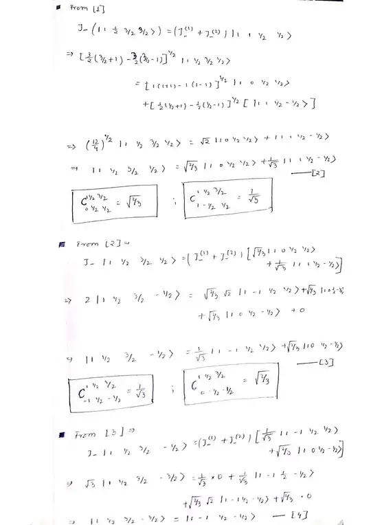

Here I show simple derivation of CG coefficient for j1=1/2 and j2=1. It can be very helpful.

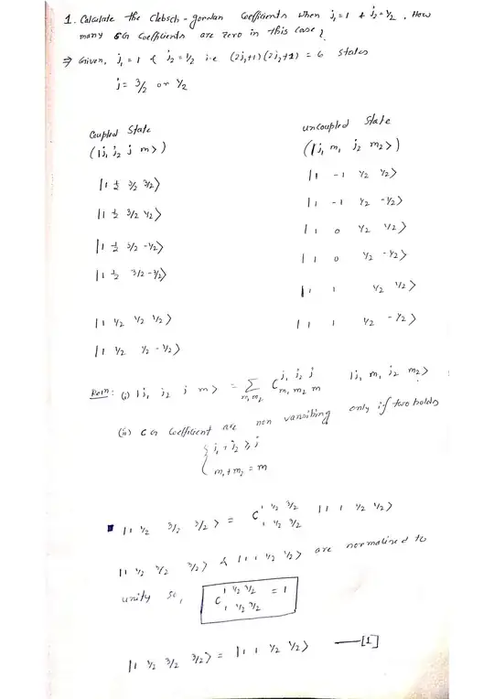

This is the first page for the derivation of CG coefficient.

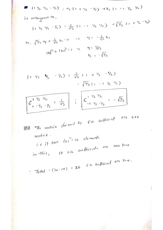

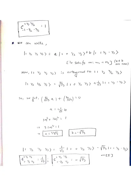

So we can get easily through CG coefficient. CG coefficient derivation is like for the case of j1=1/2 and j2=1.
