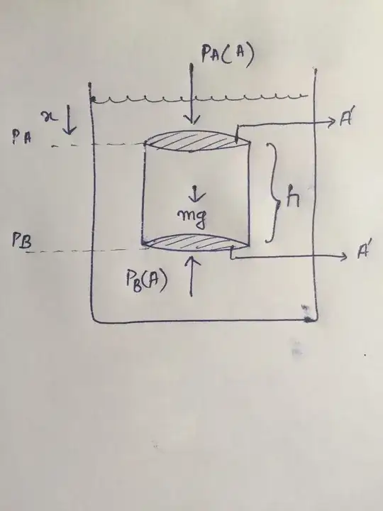

Consider a vessel filled with liquid of density d Lets take two points A and B such that A is x distance below the surface and B is x+h below the surface.
cylinder
Now consider a cylinder of fluid with ends A and B and area of crossection A'.
This cylinder is in equilibrium hence the forces must balance out hence
$ A'(Pb - Pa) = mg = A'hdg $ $ Pb = Pa + hdg $
That is the pressure difference between the points.
The example that you gave was basically a cylinder of A' = 0 and h = 0 hence the pressure difference was also zero.
You can clearly see that its the force of $mg$ downwards that actually leads to a pressure difference and thus pressure is simply a consequence of gravity on a fluid.
