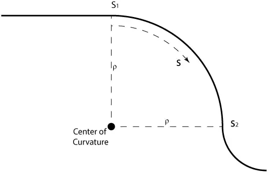

A vehicle (modeled as a particle) enters into a circular arc trajectory at point $s_1$ (given), see figure below. If at $s_2$ the speed of the vehicle is not to exceed a given speed $v_2 \geq 0$, find $v(s)$ (a function) that minimizes the time it takes for the vehicle to travel from $s_1$ to $s_2$ given also that the magnitude of the total acceleration $\|\vec{a}\|$ of the vehicle is not to exceed a known (positive) constant $\alpha$ (i.e. $0 \leq \|\vec{a}\| \leq \alpha$). The radius $\rho$ of the circular arc between $s_1$ and $s_2$ and therefore the curvature $k = 1 / \rho$ are also known and contant.
This might be the case for example in situations like the one shown in the schematic below, since the curvature of the segment starting at $s_2$ is larger (or the radius is smaller) than the one starting at $s_1$, the feasible speed at $s_2$ will be restricted by that second tight corner and the acceleration constraint.

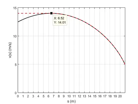

In the figure below, in the black solid line, is the graph of
$$v(s) = v_{lim}\ \sqrt{\sin\left(A + 2\, k\, (s_2 - s)\right)}$$
and in the red broken line the graph of
$$v(s) = v_{lim}\ \sqrt{\sin\left(\min\left(A + 2\, k\, (s_2 - s), \pi/2\right)\right)}$$
(notice the min(a,b) function, where min(a,b) gives the minimum between numbers a and b) for some values of $v_2$, $\alpha$, $\rho$ and $s_2$.
It is obvious that the optimal velocity function $v(s)$ (the one that minimizes the time to reach $s_2 = 20.94(m)$) is provided by the red broken line. The two lines are identical for $s > 6.52\ (m)$ but not for $s < 6.52\ (m)$. At that point the limit velocity $v_{lim}$ has been reached. That is the maximum velocity at which the particle can travel while still maintaining the circular trajectory given the acceleration constraint.
