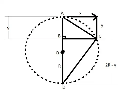

For the sake of simplicity, let us consider throwing a ball off the surface of the earth as shown in the diagram instead of considering a moon orbiting the earth. However, note that, the surface can be any circle around the earth. We will use this idea to generalize the formula later.
In the above figure, a ball was thrown at a velocity $v$ from the surface horizontally. The ball travels distance $x$ in the horizontal direction and falls a distance $y$ in the vertical direction in one second (why one second? we can treat $x$ and $y$ as components of the velocity of the ball). On the surface of the earth, the ball would fall 5m in the first second.
Some quick observations before we begin:
  1. $BC = x$
  2. $\angle ACD =$ right angle (AD is diameter)
  3. $\angle ACB = \angle CDB$
  4. $\triangle ABC$ and $\triangle CBD$ are right triangles
  5. $tan(\angle ACB) = \frac{y}{x}$
  6. $tan(\angle ACB) = \frac{x}{2R - y}$
  7. $2R$ is significantly larger than $y$
$$tan(\angle ACB) = tan(\angle ACDB)$$
$$\frac{y}{x} = \frac{x}{2R - y}$$
I could have made use of calculus to derive but it isn't really needed as it would unnecessarily complicate the answer. $$2R - y \approx 2R$$
To be honest, in the limit where $y$ tends to zero, this is not an approximation.
$$\frac{x}{y} = \frac{2R}{x}$$
Solving for $x$ in terms of the other variables, you get,
$$x = \sqrt{2Ry} - (1)$$
We had considered $y$ as the distance the object would travel in one second. We can write the same quantity in terms of $g$ on the surface.
$$y = \frac{g}{2} - (2)$$
Substituting $(2)$ in $(1)$, we get,
$$x = \sqrt{Rg}$$
We had earlier assumed that $x$ is the distance traveled by the ball in one second. Therefore, $x$ is the horizontal velocity.
$$v = \sqrt{Rg} - (3)$$
If you have studied gravitation, you'd immediately notice that the above formula gives the orbital velocity of objects orbiting the earth near the surface.

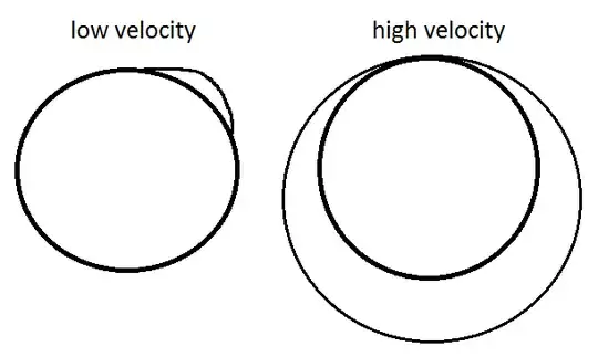

Imagine you are throwing a ball horizontally. You can split the motion of the ball in two parts. If you only look at the vertical component the ball is in free fall (just as if you dropped it). On the other hand, the horizontal component of the ball's motion is not affected by gravity. Now at some point the ball will hit ground. But if you keep increasing the initial velocity with which you throw the ball, at some point there will not be any ground (because earth is not flat), so the ball will still be in free fall towards earth, but the horizontal component of the velocity (which is constant) will prevent it from hitting ground.
That's the situation with the moon. It is freely falling towards earth, while its speed along the orbit does not change in magnitude and prevents it from hitting earth.
There are several scenario possible for the two-body motion in a gravitational field. Roughly speaking, depending on the velocity/enery of the ball/moon, you go from (1) falling back to earth via (2) orbiting earth in elliptic or circular orbit (this is the situation for the planets around sun and for the moon around earth) via (3) parabolic path (almost the case for the Hale-Bopp comet) to a (4) hyperbolic path (some comets). In "3" and "4" the "ball" is not in a closed orbit.
