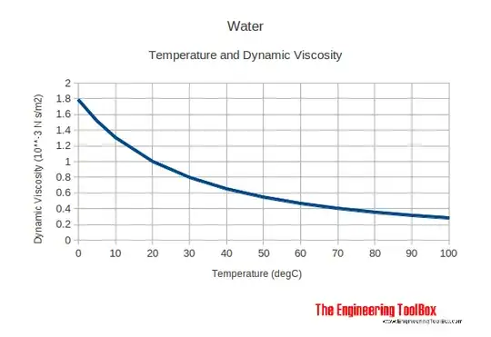

This also answered the related/duplicate question of why water looks visibly different when pouring a boiled kettle which has cooled below the point of having visible wet steam (~190 F, ~90 C), and an unboiled kettle with room-temperature water (~70 F, 20 C).
That is: before I've filled my mug more than 1/4 the way, I can tell if I've forgotten to boil the kettle. The colder, more viscous water looks noticeably more laminar, because it is three times more viscous.
This was surprising to me: I'd learned that water viscosity does not change "significantly" as temperature falls.
From the graph, for the temperatures described in the OP (5 C and 100 C), they'll be getting closer to six times more viscous, so a difference should be audible between the cold "glop" and the hot "splish".
graph of water temperature vs viscosity (image via engineeringtoolbox]3)
