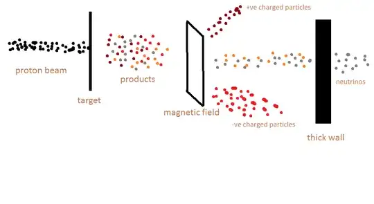

Producing neutrinos is relatively easier than detecting neutrinos. Smashing protons against a target will produce a beam of new particles. This is a very diverse beam of particles consisting of heavy and light, charged and uncharged (neutrons, protons, electrons, pions, neutrinos and what not). Some of these particles such as protons are unwanted particles which must be separated while some particles are useful such as pions which decay into muons and electrons producing neutrinos as side products.
$$\pi^+ \rightarrow \mu^+ + \nu_{\mu}$$ $$\pi^- \rightarrow \mu^- + \nu_{\mu}$$
The charged particles can be removed easily by surrounding the beam with a magnetic field. The charged particles will deflect in a curved path and hence can be separated. Neutrinos being uncharged are not affected by the magnetic field. The heavy particles can also be removed easily by using a thick steal-cement slab. Neutrinos feebly interact with matter and hence will easily make its way through the slab. Ultimately, you will be left with a beam consisting of neutrinos in majority.
