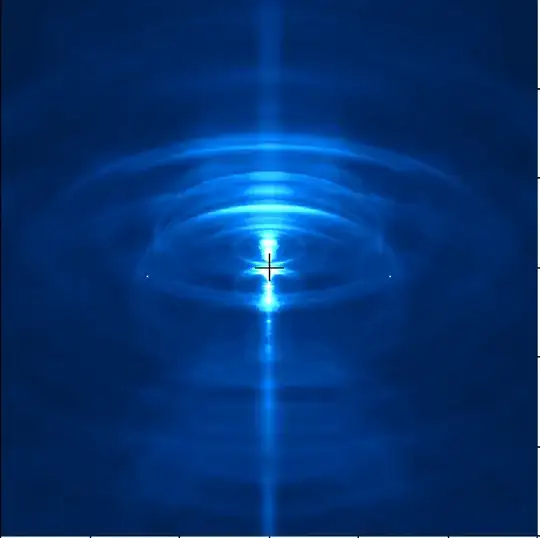

[simplified version] The suspected primary cause of the formation of relativistic jets for pulsars and magnitars is magnetic hoop stresses which cause the bulk flow away from these objects, to be collomated and redirected from the equitorial disc back towards the polar axis, this causes large increases in the total pressure in the polar region (outside of the termination shock) and causes vast accelleration along the rotation axis and away from the star (note, there is much more going on but this is the general gist!). The formed jets remain collimated (cyclindrical - with perhaps some sausage instabilities as it travels away from the star) due to the 'local' Z-pinch in the 'vacinity' of the star (see here for an awesome animation of such a flow). A simulation of the Crab nebula showing the synchrotron emmission from such jets is below
Simulations of the emmision from the Crab Nebula - showing the polar jets
these simulations tell us that a mechanism like that discribed is at work, because when we compare them to the real images we find a remarkable resemblance
