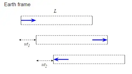

It isn't clear which bit is foxing you, so let's go through the argument:
Light clock
This is viewed from the Earth frame i.e. the frame in which the light clock is moving. In this frame the length iof the clock is $L$. In the outward trip the light moves a distance $L+ut_1$ in a time $t_1$, and since light moves at the speed of light we get:
$$ L+ut_1 = ct_1 $$
Likewise for the return trip the light moves a distance $L-ut_2$ in a time $t_2$ so:
$$ L-ut_1 = ct_2 $$
The total time is therefore:
$$ t = t_1 + t_2 = \frac{2L}{c}\frac{1}{1 - u^2/c^2} \tag{1} $$
Now switch to the rest frame of the clock. In this frame the length of the clock is $L_0$. In this frame the light simply moves a distance $2L_0$ in a time $t_0$, and again light moves at the speed of light so:
$$ t_0 = \frac{2L}{c} $$
Now the book uses the previously derived result that:
$$ t = \frac{t_0}{\sqrt{1-u^2/c^2}} = \frac{2L_0/c}{\sqrt{1-u^2/c^2}} \tag{2} $$
This is just the usual equation for time dilation. The time $t$ is the same time in equations (1) and (2), so we just set them equal to get:
$$ \frac{2L}{c}\frac{1}{1 - u^2/c^2} = \frac{2L_0/c}{\sqrt{1-u^2/c^2}} $$
And this rearranges to the final result:
$$ L = L_0\sqrt{1-u^2/c^2} $$
