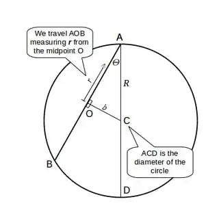

On wikipedia > gravity train, the time to go from any point A to any point B at the surface of the earth (assuming earth is a perfect sphere and absence of friction) by a straight line takes a constant ~42 minutes.
Intuitively, I would expect that a fastest path would be curved and pass closer to the center of the earth.
What is the fastest path between two points A and B with a gravity train?
