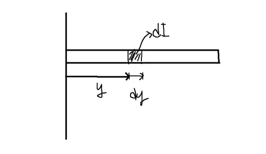

The way I've been taught to apply calculus to physics problems is to consider a small element at a general position and write an equation for that element and then to integrate it.
For e.g enter image description here
To find the moment of inertia of this rod as a function of y, I write the equation for the moment of inertia of this element at a distance of y
$dI = dm y^2$ here $dm = \rho dy$ where $\rho$ is the density Then I integrate this from $y = 0$ to $y = y$ to sum up the moment of inertia of these little elements up til the distance = $y$ to get the moment of inertia as a function of y
But I've never really understood this "procedure." Isn't $dI$ the infinitesimal $change$ in the moment of inertia function $I(y)$ for a change of $dy$ rather than the moment of inertia of this tiny element? Isn't what we should be trying to do is find the rate of change of $I(y)$ and integrate it w.r.t $y$ to the original function?
How can we just treat it as the moment of inertia of the tiny element and then sum these up using integration?

This is a good question. You are misinterpreting the definition of the moment of inertia function $I(y)$. For a specific value of $y$, $I(y)$ does not mean "the contribution to the moment of inertia from the mass at distance $y$." It means "the total moment of inertia due to all the masses between distance $0$ and distance $y$." This is why, to find the moment of inertia of a rod of length $L$, you just plug in $y=L$ to get $I(L)$ instead of integrating the function. Since $I(y)$ is the total moment of inertia due to all the masses up to distance $y$, and $I(y + dy)$ is the total moment of inertia for a slightly longer rod, if you subtract the two, you get that $dI = I(y + dy) - I(y)$ is just the contribution to the moment of inertia from the length of rod at distance $y$.
In general, for these types of problems you have two functions you care about: a function $F(x)$ that represents "the sum of all the contributions from $0$ to $x$," and a function $f(x)$ that represents "the contribution just from the stuff at point $x$," which is typically some kind of density. The key mathematical relation is that $f(x) = \frac{dF}{dx}$, or equivalently $F(x) = \int_0^x f(y)\ dy$. In this case, $I(y)$ corresponds to the "integrated" function $F(x)$, not the "density" function $f(x)$.

In your example, really you are saying that the inertia of a small part of the structure with mass $\Delta m$ is (approximately) $\Delta I = y^2 \Delta m$.
Summing over all the small parts, the inertia of the whole structure is then $$I = \sum_{\text{volume}} \Delta I = \sum_{\text{mass}} y^2 \Delta M = \sum_{\text{length}} y^2 \rho\, \Delta y.$$ In the limit as the individual $\Delta M$'s become smaller and smaller, you can replace the sum with an integral and (if the rod has length $L$) write $$I = \int_0^L y^2 \rho\, dy.$$
Note: this didn't refer to anything like "the moment of inertia function $I(y)$". The M.I. of one specific rod isn't a "function" of anything - it's a constant! If you really wanted to write a function for the M.I. of any rod, it would be something like $I(\rho, L)$ not $I(y)$, because the M.I. depends on the density and the length of the rod. It does not depend on the arbitrary coordinate system (i.e. $y$) that you chose to do the calculations.
