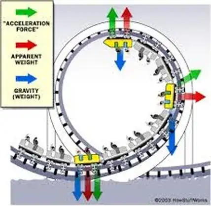

I guess you want to a roller coaster path with constant apparent gravity (in magnitude). That would be a clothoid loop.
Check the mathematical treatment here.
