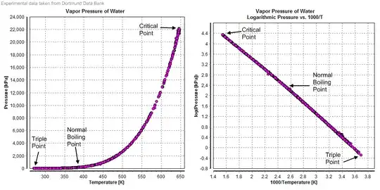

The quantity typically used to characterize this effect is the so-called vapor pressure: At finite temperatures all liquids have a non-zero vapor pressure, meaning the equilibrium partial pressure of free molecules of the liquid is greater than zero. This means that if you have liquid sitting in a closed environment (of finite volume), eventually (in equilibrium) the partial pressure from free molecules of that liquid will equal the vapor pressure. However, if you remove these free molecules somehow (say, wind blowing over a shallow puddle), or if the environment has essentially infinite volume so that the partial pressure of a liquid's molecules above the fluid's surface is less than the vapor pressure, then fluid molecules will continue to leave the body of the liquid, meaning they continue to evaporate.
The Wikipedia article I linked has more information on this. Specifically for water, here is a plot of its vapor pressure as a function of temperature (linear and logarithmic, source):
