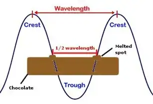

Image source: Measure the speed of light using chocolate
Use a bar of chocolate to check that the speed of light is 300,000 km/s, rather than let all that energy go to waste.
Apologies if you know this already.
Measure the distance between the melted spots, after they have formed and then double it to get the wavelength of the microwave radiation. The wave frequency is around 2.45 gigahertz.
Velocity of light = wavelength x frequency
The distance between each melted spot should be around 6 cm.
6 x 2 x 2450000000 = 29400000000 cm/s, pretty close to the speed of light.
