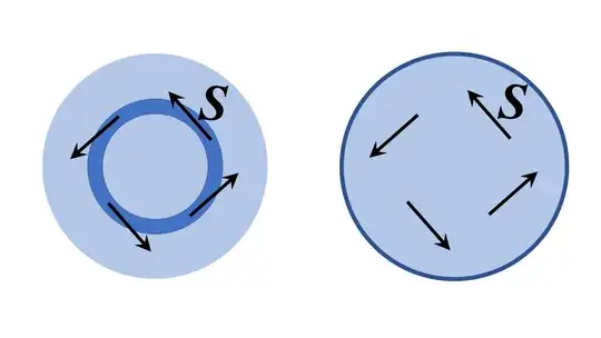

In this case, the answer is most definitely yes - it is basically the idea of an optical fiber loop, and, moreover, it can theoretically be done in a perfectly lossless way. It is not as weird or wonderful as the idea seems at first; indeed, it is simply a particular case of a resonant cavity mode called a whispering gallery mode. I have sketched two two-dimensional (i.e. of infinite extent in the $z$-direction out of the page, and with $z$-translational invariance symmetry) dielectric structures below and we'll analyze them in cylindrical polar co-ordinates below; analogous discussions hold for a circular cross section optical fiber bent into a torus and analyzed with toroidal co-ordinates but the much more doable problem below illustrates the physical principles well.
The structure on the left is a high refractive index ring of finite radius surrounded by low refractive index regions. That on the right is a dielectric region surrounded by a perfect conductor. I should think that a reasonable interpretation of your question is "can we set up a field with the Poynting vector $\mathbf{S}$ tangent to the ring, or substantially in the direction of increasing polar angle, as shown below?".
Whispering Gallery Mode
The answer (I sketch how to show this further down) is definitely yes. What you end up with are whispering gallery modes of the structures, i.e. in the left hand structure, the Poynting vector points tangent to the ring channel (in the large structure limit) and in both structures the the field's phase everywhere varies as $e^{i\,\nu\,\varphi}$, where $\nu$ is an integer - a very large big one if the ring is many wavelengths wide for the correct phase velocities.
The point is that these modes are exact solutions of Maxwell's equations, so how does this square with the well known fact that when you bend an optical fiber, it will loose light, particularly in the case of the device on the left above?
Firstly, these are not a practical devices to use: there is no way to get light in or out of them. Secondly, losses do indeed arise from bends, but in these idealized structures there are resonant conditions (which manifest themselves as the eigenvalue equations I sketch below) where radiation is coupled back into the waveguiding structure near where it leaves, and with the nett result of zero loss and zero power transfer in the radial direction, owing to the device's precise shape and the tuning of this shape to the resonant frequnecy. It is well known that a constant curvature bend has modes such as described, but if one tried to exploit these for zero loss bends, you have to have transition regions along the fiber where the curvature changes so that you can access the bend, and radiation is shed at these points where the curvature changes. See:
William L Kath & G. A Kriegsmann, "Optical Tunnelling: Radiation Losses in Bent Fibre-Optic Waveguides", IMA J. App. Math. 41(2):85-103 · January 1988
The device on the right is less mysterious, since a perfectly conducting barrier clearly leaves no way for light to leave this structure. The light can bounce around indefinitely off the perfect conductor, and, if the radius of the device is large compared with the wavelength, the Poynting vector is everywhere almost exactly in the direction of increasing polar angle.

For the device on the left, we proceed as follows.
The continuity of tangential field components at interfaces is equivalent to the continuity of the functions $G(r)=r\,F_r(r)$ and $\mathrm{d}_r (G(r))$ across the interfaces.
In the central region within the ring, the integration constants $a$ and $b$ are equal to cancel the Neumann (second kind Bessel function) logarithmic branch point at the origin so that our solution is physically reasonable. We therefore assume a solution of the form $J_\nu(k\,r)$ in the inner region. In the high refractive index region and outer region, we assume solutions of the form $G(r)=a_{co}\,H_\nu^+(k_{co}\,r) + b_{co}\,H_\nu^-(k_{co}\,r)$ in the high refractive index ("core") region and $G(r)=a_{cl}\,H_\nu^+(k_{cl}\,r) + b_{cl}\,H_\nu^-(k_{cl}\,r)$ in the "cladding" region.
The condition of continuity of both $G(r)$ and $\mathrm{d}_r G(r)$ at each of the two interfaces yields four equations for the integration constants $a_{co}$ and $b_{co}$ in the core $a_{cl}$ and $b_{cl}$ in the cladding.
These equations are straightforward, if messy, to solve.
Now it can be shown that if $|a_{cl}| = |b_{cl}|$, the radial component of the Poynting vector (which is $\mathrm{Re}\left(-i \sqrt{\frac{\epsilon}{\mu}} (\mathbf{F}_+ \times \mathbf{F}_+^*-\mathbf{F}_- \times \mathbf{F}_-^*) \right)$ in Riemann-Silberstein notation) then the radial component of the power vanishes and we have a whispering gallery mode of the structure: no power is being transferred into or out of the structure from far off. This condition, imposed on the expressions for $a_{cl}$ and $b_{cl}$ above defines an eigenvalue equation for $k$: there are only certain frequencies where these whispering gallery modes exist. At these frequencies, the Poynting vector is tangent to the high refractive index channel. At these frequencies too, the Poynting vector integrated over the transverse plane is also nought.
Moreover, there are only a finite number of such resonances.
There are always solutions for the integration constants, and the Maxwell equations solution in this case represents the case where there is power transfer continuously across the structure from afar: the waveguide is simply immersed in a field whose power source is far off.
The device on the right is easier to analyze. Here the radial electric field components must vanish at the conductor, which gives the eigenvalue equation for $k$ as $J_\nu(k\,R)=0$, where $R$ is the waveguide's radius. If we choose a very large value of $\nu$, the field is concentrated near the outer conductor, and the Poynting vector is indeed almost perfectly tangential to the conductor in the region of the high field. It is easy to solve this eigenvalue equation numerically in something like Mathematica. For example, The eigenvalue equation $J_{500}(k\,R)=0$ has the solution $k\,R=514.859311690494$; the reader is invited to make plots of the Poynting vector of the mode defined by $F_r(r) = \frac{1}{r} J_{500}\left(k\,\frac{r}{R}\right)$ in (2).

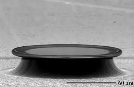

In photonics, ring resonators (RR) and microtoroids are two possible examples of this. However, in the case of the RR, light which couples to the the ring will re-couple to the photonic wire which was used to couple the light in the first place and in both of these examples you have the problem of loss which is inherent to all materials which would also deplete the energy from the cavity eventually.
This is a picture of a microtoroid which was fabricated by Caltech: enter image description here
