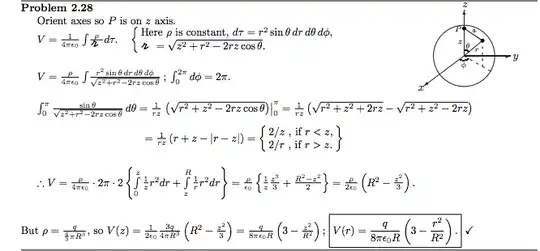

So I tried to work this and got the wrong expression, and then decided to take a peek at the solution (attached below). I understand what he's doing up until he integrates over $d\theta$. What is he doing? How does he get integrate and then after that, how does he arrive at the absolute value expression? After that interval I pick up his trail again but between those two questions, I'm completely lost.

A good explanation may be found at: http://solar.physics.montana.edu/qiuj/phys317/sol7.pdf
In more depth, what you're basically asking about is what's the substitution used to do the integration. This requires a little bit of art, but the answer is in the linked PDF and is explained sufficiently well that I won't repeat most of it here. Simply, you perform a substitution where u is equal to the argument of your square root. From here, the integration process is just turning a crank using a standard result.

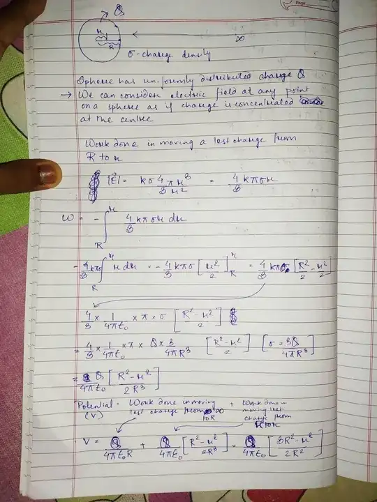

I think you might want to see this method:
