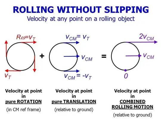

Well you must consider rotational velocity and translational velocity. Assuming that skidding is not being taken into account we have the following situation:
We can clearly see that for the bottom of the wheel the velocity in the first two pictures for translational and rotational velocity are in opposite directions and hence cancel out. Where the velocity at the top of the wheel for trans and rotational are in the same direction and can be added together.
