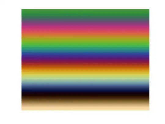

The result of all this is that you will see not simply the colors of the rainbow, but mixed colors. This is actually something that can be computed with a few lines of code. You can then convert the wavelength intensities to RGB values using conversion utilities available online (for example, see spectrumRGB.m). The result (a bit of a hack... someone might want to do this more carefully):

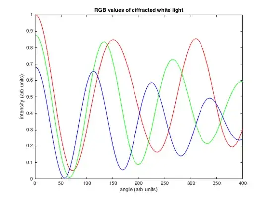

But while this shows what the RGB components may look like, it doesn't really tell you what your eyes would see. But this next plot does...:
As you can see - the "pink" color you see can be arrived at with this simple calculation. Matlab code that I used for this:

title 'RGB values of diffracted white light'
xlabel 'angle (arb units)'
ylabel 'intensity (arb units)'
