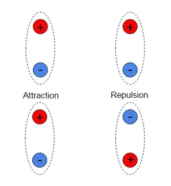

So the electric dipole has a positive end and a negative end. These are analogous to the north pole and south pole of a magnetic dipole. With this in mind it shoukld be obvious that two electric dipoles will attract if their unlike ends are pushed together and repel if their unlike ends are pushed together:
Dipole interaction
And the same argument applies to magnetic dipoles. Although magnetic charges don't exist a magnetic dipole behaves as if it has a north magnetic charge at one end and a south magnetic charge at the other. So they attract and repel in the same way that electric dipoles do.
