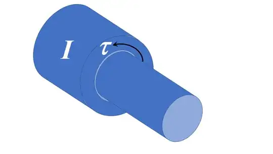

Accelerometer
I've sketched the notion of such a device above. The test inertia is a heavy bushing that is sleeved on a shaft, and the change in the bushing's state of motion requires a torque to be transmitted from the inner shaft. You could build a sensor sensitive to the torque component along the shaft's axis by, e.g. stress sensors on the faces of a key / keyway that prevents relative motion between bushing and shaft.
Because the axis of the component is changing, we need to account for the rotating reference frame through, e.g. the Euler equations. We would arrange the axis in the sketch above to be along one of the principal axes of inertia of the bushing (as indeed in it is in the sketch). With $I$ the inertia tensor, the nett torque on the bushing is:
$$\tau = I\,\dot{\omega} + \omega\times (I\,\omega)\tag{1}$$
so that the component of torque along the sensed axis is:
$$\tau_z = I_{zz}\,\dot{\omega_z} + (I_{yy}-I_{xx})\,\omega_x\,\omega_z\tag{2}$$
which is the reason for my comment that the stresses are not always in proportion to the angular acceleration. However, if we arrange the test bushing to be rotationally symmetric about the sensitive axis (as in the sketch), then $I_{yy}=I_{xx}$ and so (2) becomes the convenient equation:
$$\tau_z = I_{zz}\,\dot{\omega_z}$$
so that the sensor output is indeed proportional to the component of the rate of change of $\omega$ in the sensed direction.
But of course the sensed axis is changing direction, so we need to transform the above to non-inertial co-ordinates before integration to the rotation matrix.
