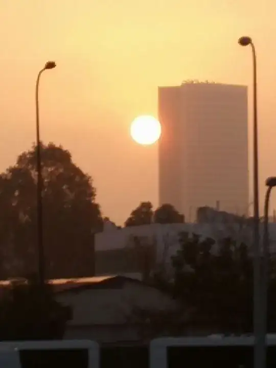

I took this photograph a few days ago, during sunrise, using my smartphone camera and digital zoom:
It seems that the sun is in front of the building. How is this explained?

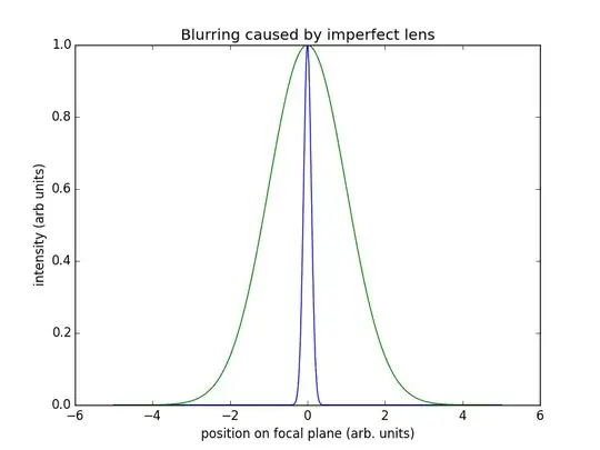

In the following image I try to illustrate how a point source that is imaged through an out-of-focus lens becomes slightly blurred:

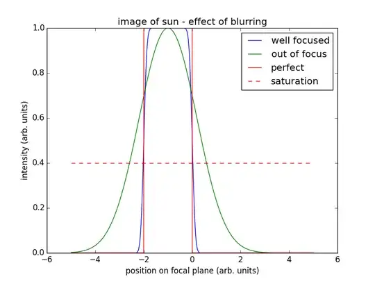

I believe that in your image, the saturation is sufficient that the edge of the sun really corresponds to part of the blurred image of the sun, as illustrated in this next image which shows the convolution of a top hat function ("the sun") with a Gaussian of different widths ("good" and "out of focus" lens).
The "saturation" line shows a possible intensity at which pixels would appear white: as you can see, for the values I chose the sun would appear larger than it really is - and therefore it would appear to "cut through" the edge of the building. Which gives the illusion that it must be in front.

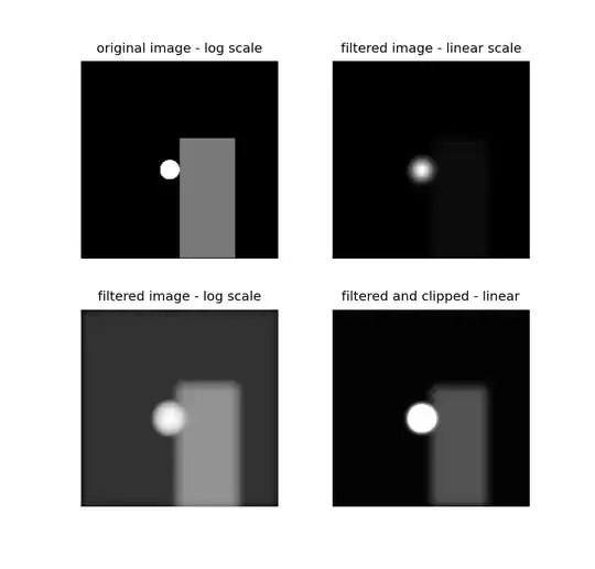

Here is a 2D demonstration of what is going on - I hope the picture and legends are self-explanatory:
I had to use log scale a couple of times because the sun is so much brighter than the "building" and background in this image.
